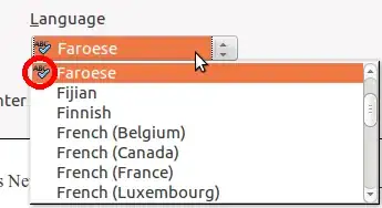

When choosing your language do you see the check besides it?enter image description here
If not then open up "Language Support" and click on "Install / Remove Languages..." and install the language you want and close LibreOffice and try again.

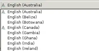

Go to -> tools-> options-> languages-> western. Then set the western language as English usa as it is enabled with spell checking.
If you've chosen anything other than English (USA), it'll likely not have spellcheck available.
That's the A with green dots seen here:
If you need a GB, AU, CA or ZA English variant, install the English Dictionaries extension.
