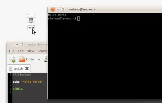

118
Put $SHELL at the end of your script:
alt text
A small flaw: since gnome-terminal isn't running the bash as it's shell, it will regard it as an application and display a warning about it when you try to close the terminal:
There is still a process running in this terminal
Closing the terminal will kill it.
I've found no nice way to hide this warning. If you want, you can disable it entirely by running:
gconftool --set /apps/gnome-terminal/global/confirm_window_close --type boolean false
This doesn't happen if you're using xterm instead of gnome-terminal; should it bother you.
