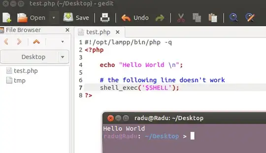

As Salem said in this comment, you are mixing bash and php code. You can use shell_exec php function to prevent this:
#!/usr/bin/php -q
<?php
    echo "Hello World \n";
    # prevent to close terminal using php
    shell_exec('$SHELL');
string shell_exec ( string $cmd ) — Execute command via shell and return the complete output as a string.
