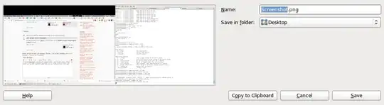

To install imagemagick, containing the program import, see the other answer. However, you can also launch gnome-screenshot from command line by calling gnome-screenshot. The applet will take the screenshot without delay and show a dialog to enter a file name:
