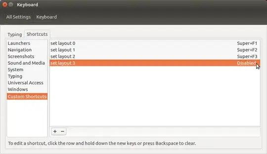

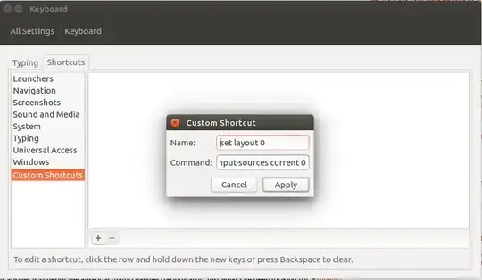

  1. Open "System Settings" > "Keyboard" > "Shortcuts" > "Custom Shortcuts"
  2. Press "+" to create a new one
  3. Add any name you like and the following command for the first layout: gsettings set org.gnome.desktop.input-sources current 0
  4. Press "Apply"
  5. Press on "Disabled" in right column for your key mapping
  6. Assign your hot key
Screenshot for step 3: enter image description here
Screenshot for step 5: enter image description here
