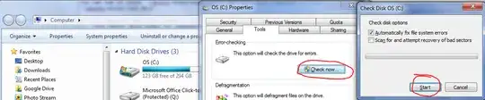

Here's how to do it from Windows 7. Go to Computer, right click on the "drive" you selected when you installed Wubi e.g. C:\, and select Properties, Tools, Error-checking Check now, and then Start:
If you installed Ubuntu on the C:\ "drive", then you have to reboot Windows to let chkdsk complete. Make sure you don't hit any key at bootup or it will cancel the scan.
