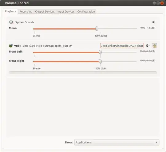

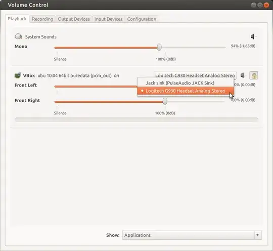

This was tested to work with ubuntu 12.04 Host and ubuntu 10.04 guest. in virtualbox 4.1.22
1) launch pulseaudio volume control in your host system.
2) launch your virtualbox guest OS (ubuntu 10.04)
3) change setting to logitech g930 view second image
