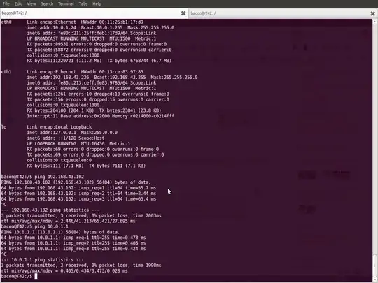

I did a quick test setup here at home, with a 10.0.1.0 network and a 192.168.43.0 network (the first my usual LAN over Ethernet the second my phone over wireless.) I have no problem pinging to either network, so I would expect the computer to be able to find printers on both networks since it automatically takes the correct network interface. I'm 99% confident you will have no problem at all (don't sue me in case of the other 1%).
two LAN's both pings work

In this case, a 192.168.1.x/24 address (eth0) would be the gateway for the the same 192.168.1.x/24. A 10.x.x.x address will be the gateway for all 10.x.x.x that fall under its subnet mask. This is actually what you see in bacon's answer. It shows a ping test where the gateway and target IP addresses are in the same network -- the network masks match exactly. 192.168.43.102 is within the same /24 network (as indicated by the 255.255.255.0 network mask) as the interface.
