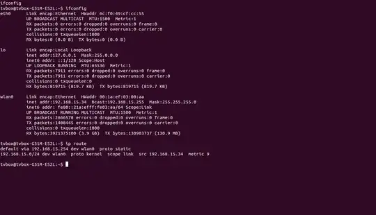

You can use ifconfig, it will show your inet address (IP) and mask.
For the gateway, issue the ip route command and take note of the default route.
ifconfigandiproute
Hope this can help you.
