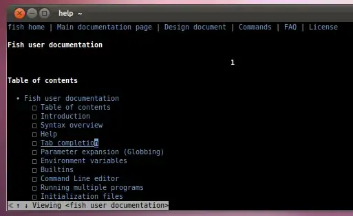

The best way to learn fish is by reading its built-in help. From within fish, just type
help
and you'll get a very nicely formatted, extensive and easy to read manual. Actually, this opens the w3m web browser, because the help is in html format:
alt text
(press q-y to exit)
