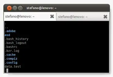

    alt text
    this shows 'ls -ah --color=always | less -R'
In contrast to more, less will let you scroll through the output. It's also a bit faster for very large listings.

Result running lsc in a terminal
