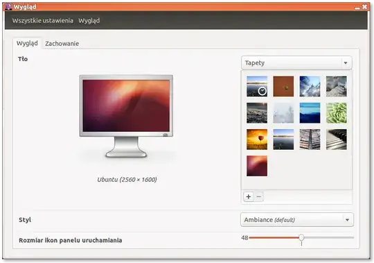

I have got this weird problem with Ambiance (it happened suddenly, no changes made by me):
weird title bar
Title bar in all apps can't be set to Ambiance, it simply doesn't change. How can I solve this problem?
