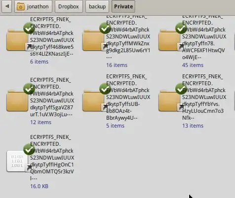

The second is symlinking selected directories from ~/.Private into the Dropbox directory. This automatically uploads (and syncs) the encrypted versions of files normally situated in ~/Private. This assumes you have set up the encrypted Private directory! It can also be initially tricky to find the correct one to link.
Ecryptfs screenshot
While neither of these is strictly encryption of a single file, as both use a container of sorts, both methods scale easily as only changed files are uploaded.

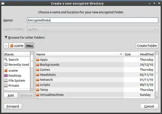

Create an encrypted container :
alt text

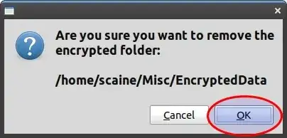

Left click on the Cryptkeeper icon, then right-click on your new container and delete it (Choose "Delete Encrypted Folder").
Choose "Ok" at the first prompt :

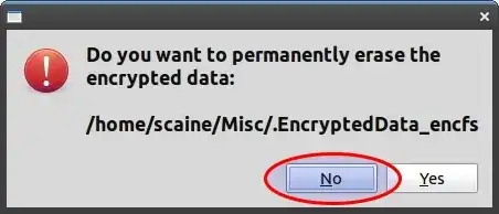

Then choose "No" at the last prompt :
alt text
