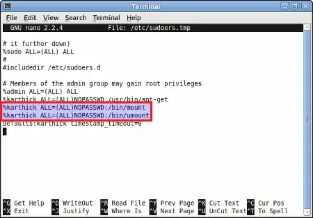

  • If you feel that you dont want to enter password on mounting and unmounting then one way is to edit sudoers file.
    sudo visudo
  • Add the following two lines at the end of your file.
    username ALL=(ALL) NOPASSWD:/bin/mount
    username ALL=(ALL) NOPASSWD:/bin/umount
    alt text

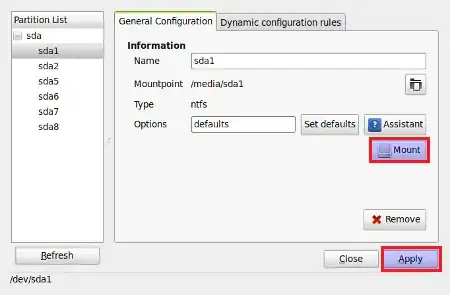

  • If you want to automount your drives at startup then install pysdm Install pysdm
    alt text
