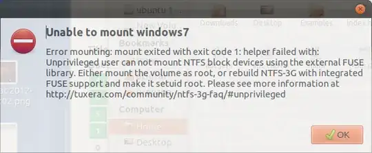

whenever try to mount ntfs partition it says
Error mounting: mount exited with exit code 1: helper failed with: Unprivileged user can not mount NTFS block devices using the external FUSE library. Either mount the volume as root, or rebuild NTFS-3G with integrated FUSE support and make it setuid root. Please see more information at http://tuxera.com/community/ntfs-3g-faq/#unprivileged I tried this answer but it wont work
my etc/fstab file

Update : Looks like you are not able to change settings with pysdm due to some bug in it - "No matter what I do with pysdm - Mount file system in read-only mode, still remains checked."
This can be fixed by manually editing /etc/fstab file . Changed
/dev/sda1                                  /media/sda1  ntfs  nls=iso8859-1,ro,umask=000,user  0  0
to
/dev/sda1                                  /media/sda1  ntfs  nls=iso8859-1,rw,umask=000,user  0  0
or even
/dev/sda1                                  /media/sda1  ntfs  nls=iso8859-1,umask=000,user  0  0
and rebooted the system.

I had the same problem caused by pysdm.
I just deleted entries made by pysdm in fstab, as I didn't want NTFS partition to automount, I just wanted to be able to mount it by clicking in Nautilus. It worked.

Hi I got a similar problem.
In my case (Ubuntu 12.04, using gparted and pysdm) I got a loading problem at start up, sdb2 was not able to mount at media/partitionName , where partitionName was the folder I set up with pysdm. In my case I was able to use and automount at start up before, and suddenly this problem started.
Then I was not able to mount it manually either, and I got the message Unable to mount.... (see figure in the first question above). I found that the problem was generated by windows hibernation. After I restarted from windows and turn it off the whole problem disappeared. I was able to see that the problem was hibernation when I tried to mount by hand:
sudo mount -t /dev/sdb2 /media/partitonName
Hope this could help some one.
