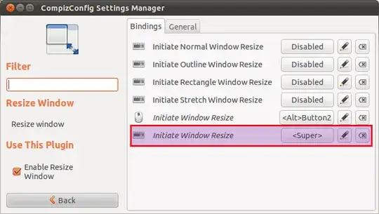

You can bind it to other things as well. You can use it as part of a key combination in for another shortcut or for an action in compiz. For example, I have my Windows key bound to the Initiate Window Resize action (because this is easier than trying to grab the sides of the window) which can be found in Compiz Config Settings Manager under Window Management -> Resize Window.
alt text
