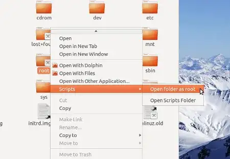

Create a simple nautilus script can also open a folder as root.
#!/bin/bash
gksudo nautilus $NAUTILUS_SCRIPT_SELECTED_FILE_PATHS

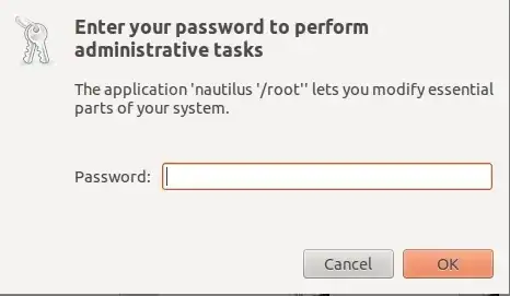

Save the above script as Open folder as root in your ~/.gnome2/nautilus-scripts/. On right click you will have an option under scripts, Open folder as root. And you can open a folder as root after providing your root password.

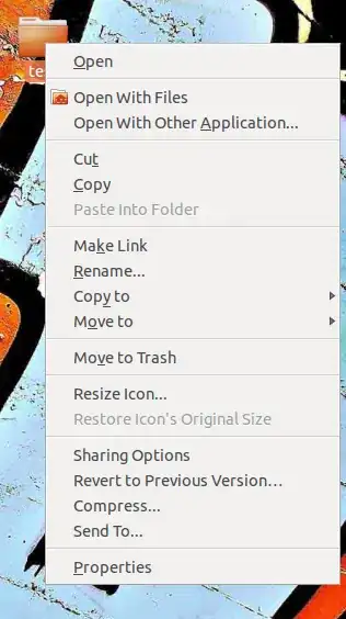

As you can see, there is no “Open as Administrator” option when you right click on a folder:
Screenshot of right-click menu

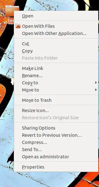

And now the “Open as Administrator” option should appear:
