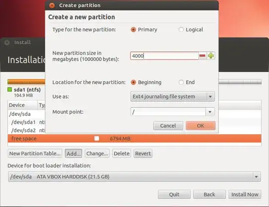

  • Choose free space for the root partition on any drive (here /sda), and press "Add..." to choose size and mountpoint:

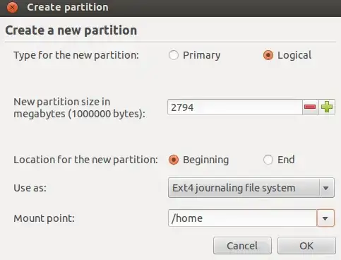

  • Do the same for your HOME partition on your harddrive. Choose montpoint /home:

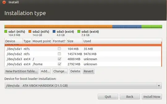

Check that everything is alright (e.g. make sure the "format" option is unticked for your Windows partitions) and proceed with partitioning and installation of Ubuntu:
