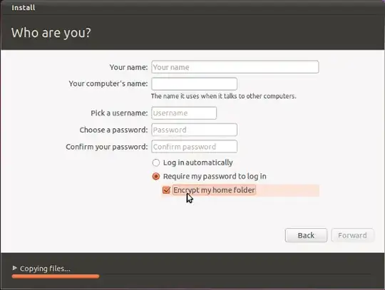

When installing Ubuntu 10.10 you are asked if you want to encrypt your file system by default.
alt text
IMO it is sufficient to encrypt '/home' and '/swap' and leave '/' non-encrypted for better perfomance especially on a netbook CPU. However you need to take care not to deliberately store private data outside /home. See also Encrypted Home.
If you really need to encrypt your whole system with dual-boot to Truecrypt encrypted Windows you need to install Grub to your Linux partition and keep your Truecrypt boot-loader in the MBR. See also Encrypted Filesystems for further reading.
