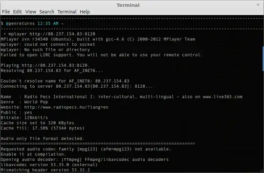

mplayer http://80.237.154.83:8120
The IP-address of an online radio station can be found over at Xat radio search.
My result :
mplayer in IPv4 networks
If your router only works with IPv4, you will need to add the option -prefer-ipv4. More recent mplayer versions require this.
mplayer -prefer-ipv4 http://80.237.154.83:8120

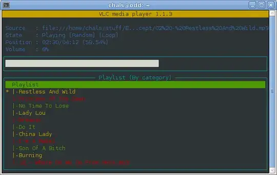

Using VLC from the command line
As usual, VLC does it all. Use cvlc to run VLC on the command line.
cvlc http://80.237.154.83:8120
cvlc us.darkmatter.aac.48k.m3u
VLC can also be invoked with a ncurses interface, as follows:
$ nvlc http://provisioning.streamtheworld.com/pls/CKFRAM.pls
or
$ vlc -I curses http://provisioning.streamtheworld.com/pls/CKFRAM.pls
Hit the H key for the much needed help.
Here is a screenshot of nvlc with a music playlist:
nvlc

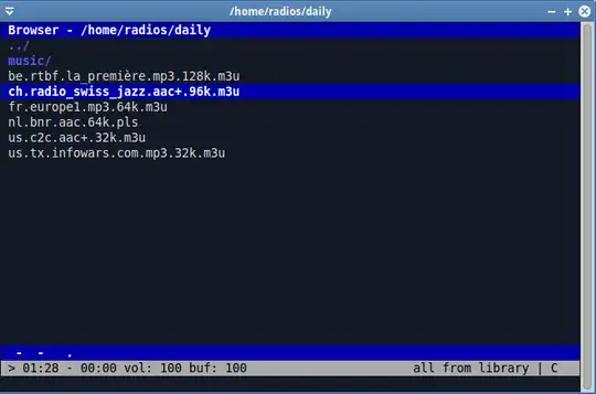

cmus also opens .m3u and .pls streams
Unlike mplayer, cmus also knows to open .m3u and .pls streams. This means less digging or "background work" to extract the stream URL from those files.
Furthermore, cmus looks nice and offers several views, a file browser and many configuration settings. cmus is available from the standard Ubuntu repositories. To get up to speed with cmus, first read the tutorial by typing the following command:
$ man cmus-tutorial

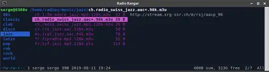

If you do not like cmus, or it is unavailable, mplayer can be made to do the same. For that purpose, I wrote the following mplay script:
#!/usr/bin/env bash
URL=$(grep -m 1 --null http "$1" |sed s/^.*http/http/ |tr -d '\r')
mplayer -prefer-ipv4 "$URL"
To navigate between directories of .m3u and .pls files, one could use the CLI file browser ranger, configured to call the above script for these file types. The struggle of setting this up pays itself back by being the fastest access method. This is what I personally use in a daily setting.
ranger

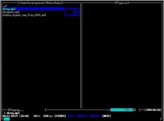

moc
Then there is also moc. MOC (music on console) is a full-screen ncurses based console audio player.
MOC
Select a file from some directory using a menu similar to Midnight Commander, and MOC will start playing all files in this directory beginning from the chosen file. There is no need to create any playlists, even though MOC handles these as well.

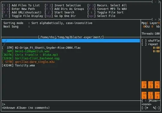

mp3blaster
More details about yet another CLI music player, mp3blaster can be found here
$ sudo apt install mp3blaster
mp3blaster

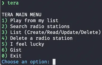

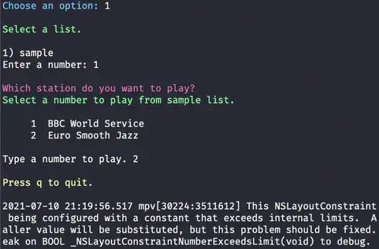

I'm the author of Tera, an interactive terminal music radio player.
  • 27780+ radio stations powered by Radio Browser API.
  • MPV, a free, open-source, and cross-platform media player.
  • CRUD favorite lists.
  • Play from a list
  • Search radio station by tag, name, language, country code, state.
  • Save a station to a list after playing.
  • Delete a radio station from a list.
  • I feel lucky menu.
  • Gist upload.
Installation
Either you clone the repo, use HomeBrew, install via deb package, or you can use Awesome package manager.
Usage
After installing Tera, you just need to run tera to run the program.
screenshot
screenshot
You can find more details here. Other options here.
