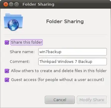

In Ubuntu Maverick, I've shared some folders using the Nautilus "Sharing Options" GUI.
alt text
I can see them from Windows 7, but when I try to access them (from Windows) it asks for a username and password. No matter what I enter, it won't let me in. How do I configure this to share normally?
Update: I've found that some of the shared folders let me in, but others don't. Of the ones that do, some of their subfolders do, others don't, etc. How can I investigate what's causing this?
