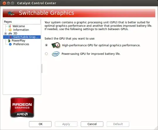

The ATI driver available at Ubuntu Additional Drivers don't install correctly. To fix this issue, install the latest stable version from the ATI suporte site and you'll get the AMD Catalyst Control Center, a GUI with an option to Switchable Graphics.
To install it, follow the instructions below.
