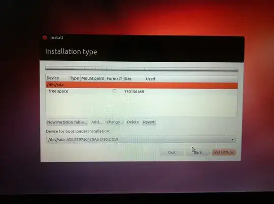

  4. I clicked forward until I got into the installation type screen enter image description here
As you can see, the installation wont show my actual details about my hard drive! I have 1 hard drive with 750 GB - 80 GB - My main drive with windows 7 OS 600GB - All of my stuff 20GB Free space that I saved for Ubuntu But the installation wont show that!

I've seen people with this problem before here on askubuntu (Ubuntu inslaller seeing the disk as one large unpartitioned space, not seeing any Windows partitions) and it usually was caused by Windows using Dynamic Disks, which is a proprietary MS extension to the standard MBR partitioning scheme.
Be careful, making any modifications to the partitions from Ubuntu installer when it can't see the existing partitions will result in data loss. You need to convert the disk to a "Basic disk" in MS terminology before proceeding.
Update: after some googling I see that Ubuntu installer should be aware of Dynamic disks and at least warn the user that it can't make modifications to the partition table. So the issue may be caused by something else. At any rate, you should not proceed until the installer sees all the partitions on the disk, forcing it to create new partitions on top will result in data loss.

I saw this too
sudo dmraid -rE
fixed it for me, from this thread:
Why doesn't the installer see all of my hard drives?
Th disk was messed up, and had some garbage metadata.
