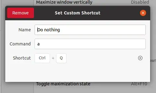

My way is going to System → PreferencesKeyboard Shortcuts (yeah I know it's not there). Here you add one more shortcut with the Name "Do nothing", with a random Command with the Shortcut Ctrl+Q. Then the deadly combo should not bother you anymore anywhere.
screenshot
