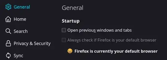

Killall firefox will force firefox to restore its tabs, no matter what your settings are. Most convenient way is to open Settings->General and untick "Open previous windows and tabs":

Go to Settings > General > Startup and then uncheck the option "Open previous windows and tabs"
