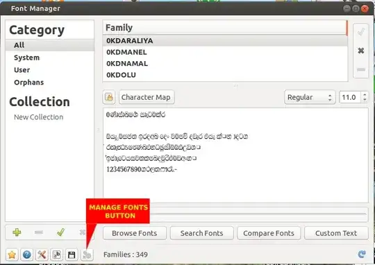

Font Manager
Can manage multiple fonts easily with this application.
Can install mutiple fonts at once.
To install new fonts click on "Manage Fonts" button as on the picture and click on "Install Fonts" in menu.
It can be installed with Software Center or with this command;
sudo apt-get install font-manager
