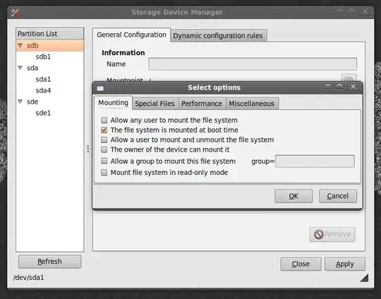

I'd suggest using PySDM if you aren't looking to manually edit configuration files.
PySDM is a Storage Device Manager that allows full customization of hard disk mountpoints without manually access to fstab. It also allows the creation of udev rules for dynamic configuration of storage devices. alt text
In Ubuntu, it can be installed by searching the Ubuntu Software Center for "pysdm". Once installed, it is available under the System --> Administration --> Storage Device Manager.
