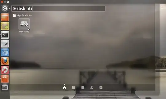

You can mount your partition drive automatic so you when you start ubuntu you dont have to connect manually.This is the step. Open disk utility.

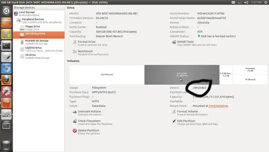

Find out where the location of your drive you want to mount (Dont mount The system (ubuntu system partition) because it's already mount by ubuntu) .Like my drive is on /dev/sda2 and the type is NTFS

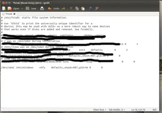

sudo gedit /etc/fstab [enter]
and insert new line, like this
Save and restart ur pc. Now you can easy access ur files under /mnt/windows directory. You can doing this to all your drive but remember to using diferent name folder and diferent /dev/sda* . if your drive type is ext4/ext3 just change ntfs to ext4 on your /etc/fstab. Like this:
/dev/sda2 /mnt/windows ext4 defaults 0 0 [save and reboot].Good Luck
