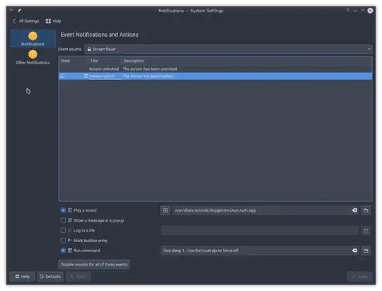

28
Found a way for KDE 4 (up to Ubuntu 14.10). For modern KDE 5 see other answer.
  1. Go to System SettingsApplication and System NotificationsManage Notifications.
  2. Select Screen Saver as the Event Source
  3. Locate and select the Screen Locked
  4. add this command to the event:
     xset dpms force off
It will turn off all displays every time it gets locked.

25
Confirmed: running the command: /bin/sleep 1 ; /usr/bin/xset dpms force off within the screen locked notification works for Plasmashell 5.10.
Go to: System Settings > Notifications > Event source "Screen Saver":
Notifications -- System Settings
andrybak
  • 349
21

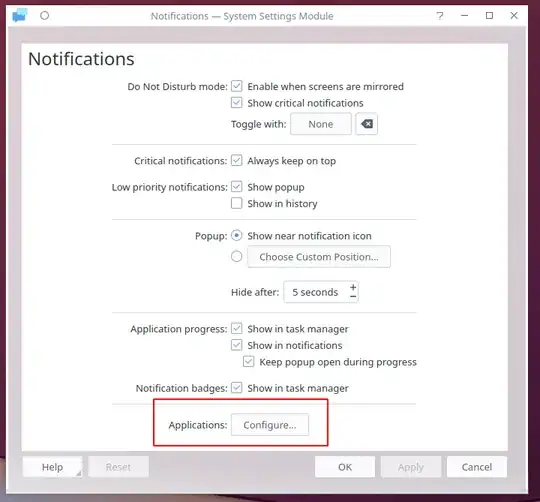

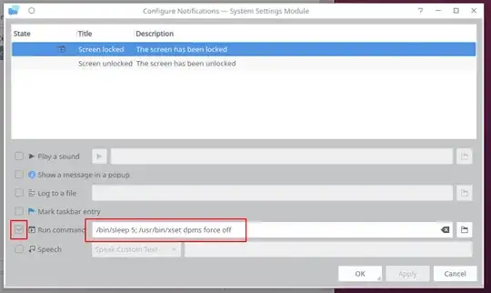

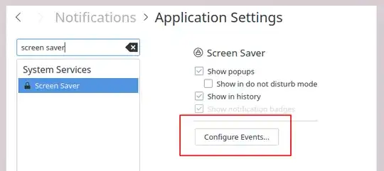

With KDE Plasma 5.18, it is a little bit different from this comment.
Search for Notification via Super and follow the screenshots below:
Notifications
Notifications - Application Settings
Configure Notifications - System Settings Module
I used /bin/sleep 5; /usr/bin/xset dpms force off instead of 1, but that's up to you.

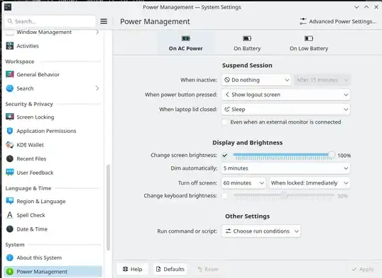

In Plasma 6, this can be configured in Power Management:
Choose the profile(s) you want - AC Power, Battery, Low Battery. In the Display and Brightness section, where it says Turn off Screen, choose When locked: Immediately.
I usually set the lower left Screen Edge to Lock Screen and with these combined, I turn the monitor off with a gesture.
