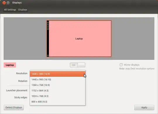

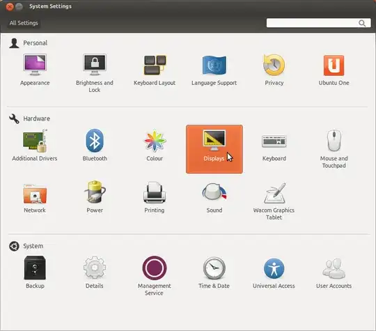

You should access System Settings - Display. There you'll see a Resolution drop-down menu. Just click on it an check the resolution you desire, as 1360x768. Then, just click Apply and you should see the changes.
Select System Settings
Select Displays from the list
Change your resolution
