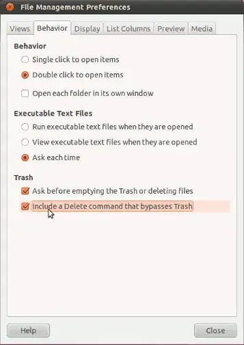

In Nautilus -> Preferences select the following
alt text
to have the option to delete files rather than putting to trash in the right-click context menu.
