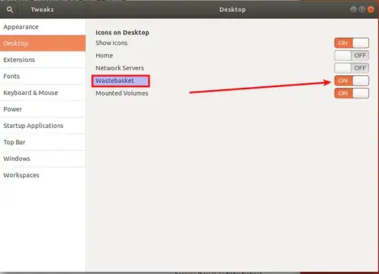

Install Gnome Tweaks from the Ubuntu Software Center and navigate to Desktop and set Wastebasket to OFF.
This hides the icon from the desktop but doesn't delete the location where trashed files are sent to [~/.local/share/Trash] which will automatically be regenerated by the system if not present.
So, a workaround to avoid deleted files even reaching there is to simply use ShiftDelete when deleting files.
