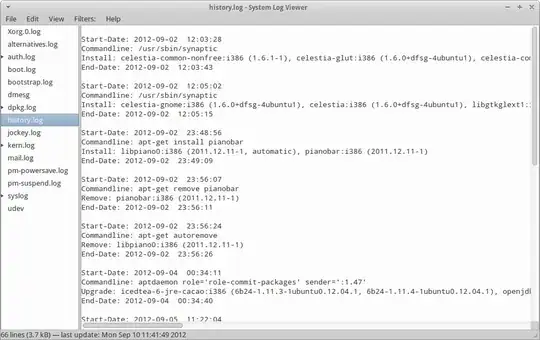

In the screenshot below most of the important logs from /var/log are shown. In that location there are often other folders from other applications such as samba or apache2 if you have it installed.
To watch a log in real time you can use gnome-system-log or, for example, use
 tail -f /var/log/kern.log
All logs can be analysed more easily either with the filter option in gnome-system-log or by using grep to search for a particular term. For example, if I wanted to find references to my SiS hardware, I could enter:
grep -i SiS /var/log/kern.log
Most of the logs in the screenshot are self-explanatory, however, here's a few quick notes:
  • auth.log deals with all privileged actions such as when you use sudo in the terminal or run gui programs such as synaptic.
  • kern.log records all kernel activity and can be useful for diagnosing errors with hardware.
  • dpkg.log is a very detailed account of packages installed
  • syslog contains both information from the kernel and OS information
  • xorg.log contains information on the (largely automatic) setup of your display
  • udev is particularly useful as it contains some details about the setup of hardware that could be useful to record for the future.
  • history.log (as seen in the screenshot) is from /var/log/apt and contains the history of your updates and installations.
