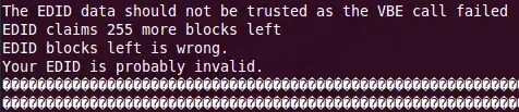

A common cause of this problem is the monitor sending bad (or no) resolution information to the driver. The driver then restricts itself to common defaults (e.g. 640x480 or 800x600, or sometimes 1024x768). Sometimes a bad cable is at fault.
So first verify if your monitor info is getting through properly, and if not react:
  1. Run sudo get-edid to verify the extended display data. For example I get:
The EDID data should not be trusted as the VBE call failed. EDID claims 255 more blocks left EDID blocks left is wrong. Your EDID is probably invalid.
  1. Download Phoenix EDID Designer and run it with wine Phoenix.exe. In a few clicks you can set the native resolution of your monitor, invent a manufacturer ID and serial number, and be on your way. Save this as a "raw" file. To keep things simple enter only the native resolution of your monitor.
  2. Back up xorg.conf and add a CustomEDID option:
    Section "Device" VendorName "NVIDIA Corporation" BoardName "GeForce GT 430" ... Option "CustomEDID" "DFP-0:/home/bnesbitt/XP-17-EDID.raw" EndSection
  3. Restart the X server or (if you're brave) reboot.
For clarity that error message was 'The EDID data should not be trusted as the VBE call failed. EDID claims 255 more blocks left EDID blocks left is wrong. Your EDID is probably invalid.'.
