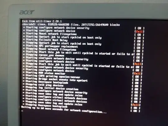

I have a "Intel 82567LM Gigabit Network Connection" and "Intel Wifi Link 5100 AGN" I went to search for linux drivers. I then found this driver, http://downloadcenter.intel.com/Detail_Desc.aspx?agr=Y&DwnldID=15817&lang=eng&OSVersion=Linux*&DownloadType=Drivers. I installed it. Now after a reboot I find out my network connection is broken and can not get access to internet anymore. It seems the driver is incompatible :(
Now is it possible to fix this issue? Or might it better just to reinstall ubuntu?
Relevant images: enter image description here enter image description here

With some help of a guy on ubuntuforums.org I fixed this issue. I had to reinstall the network manager.
sudo apt-get install --reinstall network-manager
However due to the fact I had no internet on my OS I started up with ubuntu from USB where internet still worked and then downloaded the package from.
http://packages.ubuntu.com/precise/net/network-manager
The whole topic can be found at:
http://ubuntuforums.org/showthread.php?t=2054615
