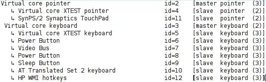

After the terminal opens type xinput list
Look for the device that is the one you want to work with. Grab the ID from the input you want to work with.
In my case i have the following output:
xinput
The one i want to work with is SynPS/2 Synaptics TouchPad with an ID of 11.

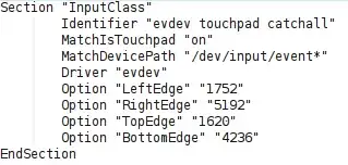

Open 10-evdev.conf: sudo nano 10-evdev.conf
Inside the 10-evdev.conf file you will find several InputClass Sections. You need to look for the section that has MatchIsTouchpad "on" in it. That would be the third one for me.
ADD at the bottom of the section the 4 positions in order like this
10-evdev.conf
SAVE and Reboot. This is to test if it is working. If for some reason you made a mistake, select in the grub menu Recovery Mode, load in terminal as root and edit the file again and remove the lines or repair the problem. Either way, if you run terminal as root in the recovery mode, type startx and it will log out where the error is found and how to fix it. The beauty of linux is that it not only SHOWS you where the error is, in most cases it TELLS you how to fix it.
If it reboots normally then NOW YOU CAN START EDITING. Go to 10-evdev.conf:
And start lowering the values to the one you feel more perfect.
In my case i lowered the RightEdge value every 1000 points. Just for testing. Of course reducing the RightEdge increases the space you have to SCROLL up/down. This way, you now have the ability to increase/decrease every area of your synaptic, including the scrolling area. And this answers your question.
Let us now take the code you put up in the question: xinput --set-prop --type=int --format=32 11 252 1781 5125 1646 4582
In your case you have:
Option "LeftEdge" "1781"
Option "RightEdge" "5125"
Option "TopEdge" "1646"
Option "BottomEdge" "4582"
Simply edit the section in 10-evdev.conf with your values. Then start lowering the RighEdge value. I recommend to start with lowering every 512 points (since 5125 divided by 10 = 512.5 which is 10% of the total). So you would be modifying 10% each time you lower it.
