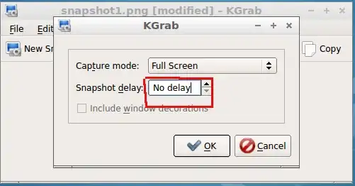

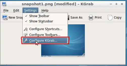

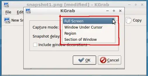

However, certain actions can't be captured using the PrtSc button. Sometimes a time delay is required in order to begin a specific function. I use Kgrab
enter image description here enter image description here enter image description here

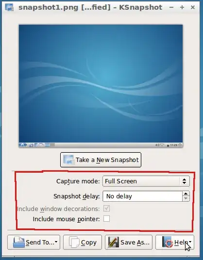

or Ksnapshot
As you can see both have the options to choose full screen, wndows, etc.., and both have time delay.

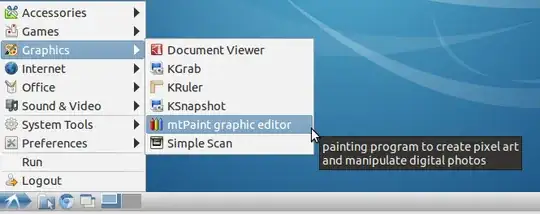

You can use mtPaint. It comes default on Lubuntu. In the menu, there's a timedelayed screenshot option. Not as easy as the above, but it will do the job.
