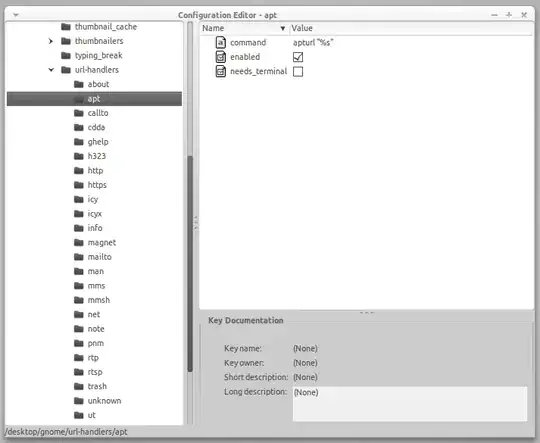

Make sure they are all set correctly:
  • Hit Alt+F2
  • Enter gconf-editor
  • Navigate to the /desktop/gnome/url-handlers/apt/command, it should be set to apturl "%s".
