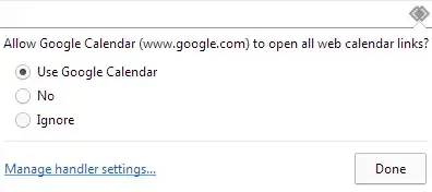

In newer versions of Chromium/Chrome, you need to login to google calendar and click the overlapped diamond icon in the address bar.
Screenshot
Select "Use Google Calendar", then click done. This will register google calendar as a handler for webcal links.

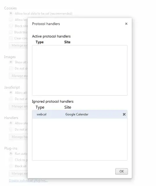

If you have accidentally answered with No on this question, you can press the Wrench toolbar button and go to Settings. Click Show advanced settings, find Content settings... (just after Privacy header) and find the Manage handlers button. Click the X next to the ignored protocol you wish to delete. Alternatively, you can type in protocol handlers search box in Chromium settings.See the screenshot below.
Undo ignore protocol handler in Chromium browser

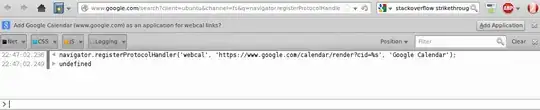

I found this post on stackexchange which explains how to achieve the same thing in Firefox, but this doesn't work for me on firefox 12 and 15: this works for me if I disable the Never save history option (Private browsing mode):
Go to Google Calendar's site and press Ctrl+Shift+K.
Paste this after the > sign:
navigator.registerProtocolHandler("webcal","https://www.google.com/calendar/render?cid=%s","Google Calendar");
Press the enter key and click the Add application button which should appear below the toolbar.
Firefox console
Firefox accept protocol hanlder
