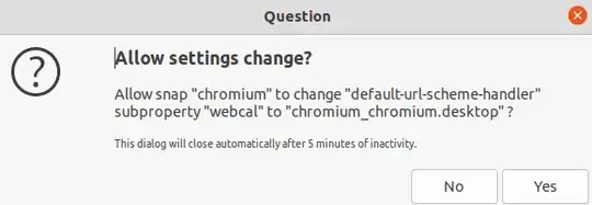

Each time I open Google Calendar in Chromium (snap edition), I get this dialog:
Snap Chromium webcal dialog
No matter whether I press Yes or No, I get the same dialog again later. Note that I flip between two different Google accounts' calendars, which might be contributing to this problem.
How do I get this dialog to stop appearing?

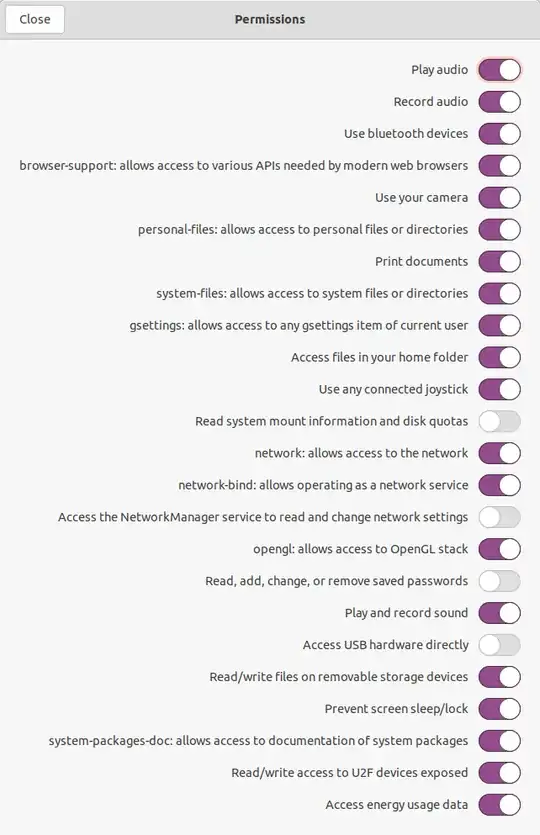

Permissions:
Chromium snap permissions
Sample Flow:
  • Start with Chromium closed
  • Open Chromium
  • Open a tab for Calendar A: get the popup
  • Click Yes in the popup
  • Close Chromium
  • Open Chromium
  • Open a tab for Calendar A: do not get the popup
  • Open a tab for Calendar B: get the popup
  • Close Chromium
  • Open Chromium
  • Open a tab for Calendar B: do not get the popup

Okay, I think I just found it. Go to SettingsSecurity and PrivacySite SettingsAdditional PermissionsProtocol Handlers (or copy and paste the following in the browser's address bar: chrome://settings/handlers) and make sure Calendar is not allowed. Alternately, if you want you can disable every site from asking.

  1. Check the status of your configuration as shown here at each point in the sequence you described, and possibly others.

  3. Check whether default-url-scheme-handler:webcal is a setting of snap or chromium.
