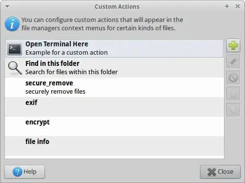

In thunar, if you go to edit > configure custom actions, you will see the menu as below (minus my custom actions of course):
You can either create a new custom action (see the discussion below) or edit an existing one. There are many useful examples at the Xfce site and at the Ubuntu wiki, so there is no need to go through them all here, but we will just discuss a few examples to display the usefulness of this feature in Thunar.

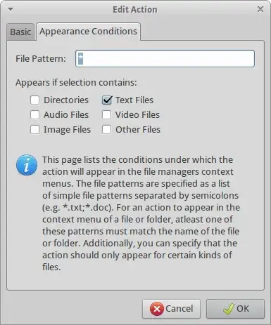

and then make sure that the correct file types were selected in the Appearance Conditions menu (as I have done for a different example in screenshot 3).

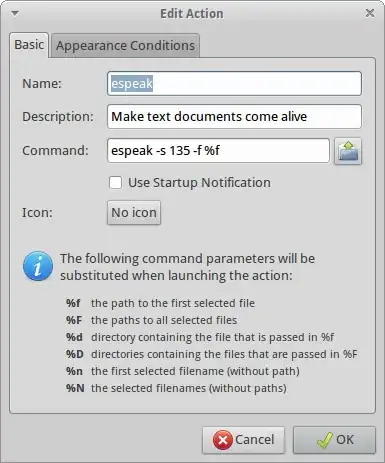

However, to use a safer example than srm, we can use the example of espeak, so that we can get espeak to read any text file to us. We would create a new custom action and then we would put in the command box (as in screenshot 2)
espeak -s 135 -f %f
Espeak needs to be installed if it isn't already (with sudo apt-get install espeak); the -s option I have used just slows down the speed of the speech a bit; you can specify other parameters as well like different voices, but the -f switch must always go before %f as it shows espeak the text input file to use.
(You can add an icon if you wish (see the screenshot below), so that the context menu looks more interesting.)

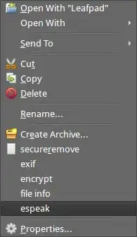

Now, only when you right click a text file, will the espeak option come up, as in the screenshot below.

To restrict a command to a certain type of files:
  • only to txt: under 'Appearance conditions' tab, check 'Text files', and then add *.txt for 'File pattern'.
  • only for png: check 'Image files', and *.png for 'File pattern'.
  • only for flv: 'Video files', and *.flv.
  • for other files, like pdf: check 'Other files', and add *.pdf. etc.
