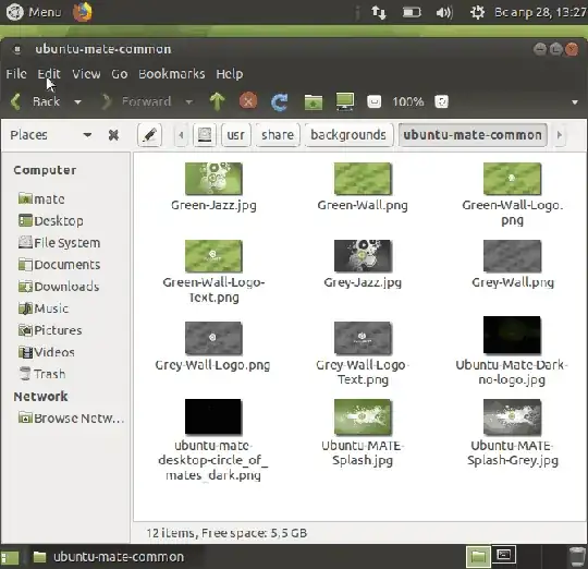

Personally I prefer to use Caja from MATE DE (GNOME 2 fork), below I give illustrations of its functionality:
  • filters

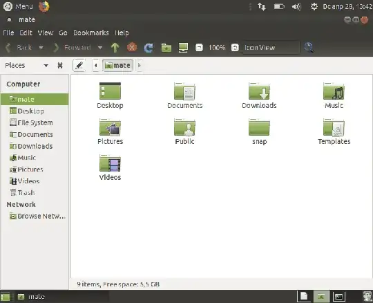

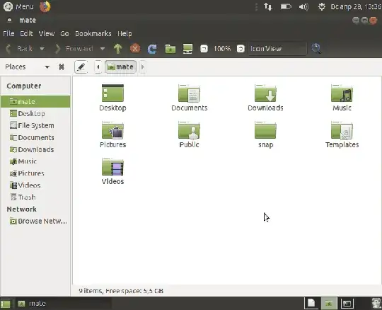

    1. Filters for current view is done by clicking Ctrl+S (or selecting EditSelect Items Matching...):
      select items matching
    2. Other way to filter items is to use search function by clicking special button named Search documents and folders by name:
      search
  • multi-tabs

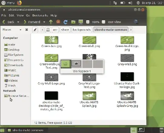

    1. Tabs are created by clicking Ctrl+T (or selecting FileNew Tab):
      tabs
    2. You can use split view with F3 (or selecting ViewExtra Pane):
      extra pane
      As it shown above this feature is very useful with Copy To or Move To actions.
  • scripting
    Scripting is done by
    1. using Caja Actions scripts. This feature is installed with caja-actions package and configurable from Caja-Actions Configuration Tool (caja-actions-config-tool). See other answer for details.
    2. using Caja Python extensions. This feature is installed with caja-extensions-common package. The user scripts should be placed in ~/.local/share/caja-python/extensions. See other answer for details.
Some additional remarks:

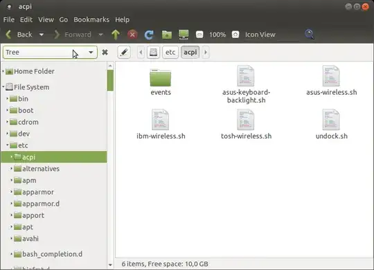

  • By default its Side Pane shows Places, but you can switch it to Tree view:
    Tree view

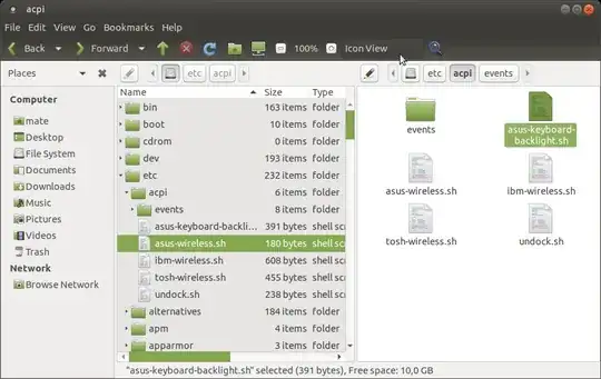

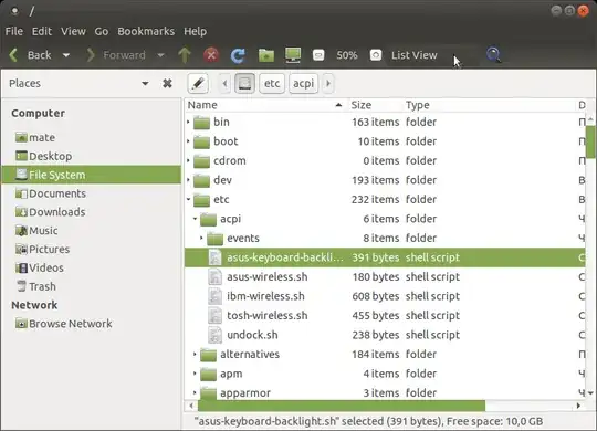

  • You can combine Places view in side pane with List View of main panel to show directory tree:
    List view with three
  • The Extra Pane (with F3) allows to combine views - for example List View in the left and Icon View in the right:
    List View + Icon View
If you are willing to try Caja you can install it with sudo apt-get install caja.
