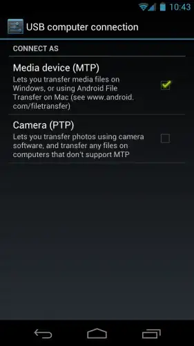

Connect your Android phone to your computer. On your phone, open up the notification drawer, and click on USB Connection type. Make sure that MTP is selected.
MTP Mode
