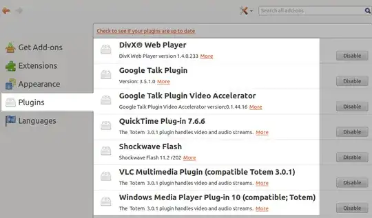

For Firefox,
Open Tools/Add-ons/Plugins (Keyboard shortcut is Shift+Ctrl+A) and find it on the list. Click the 'Disable' button to the right of it to disable the plugin. (Note that I've never bothered installing it so it's not present in my screenshot. If you have it installed you will see it here.)
FF plugins

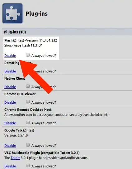

For Chrome,
Go to chrome://plugins/. Find it in the list of plugins and click on 'Disable'. (Once again I am using Flash in my screenshot example because I never installed Java.)
Chrome plugins dialog

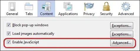

Note that the Java plugin and Javascript are two different things. See here [Java.com] or here [stackoverflow.com] for an explanation of the differences.

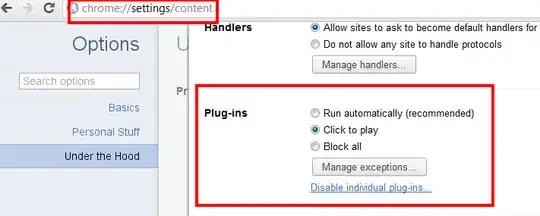

For Chrome:
Under the Plug-ins section of the settings url: chrome://settings/content select "Block All".
With this option enabled, when you want to run plugins on a page you have 3 options:
1.Right click on the plugin and choose "Run this plug-in" from the context menu
2.Click the plugin icon in the URL bar and choose "Run all plug-ins this time
3.Add an exception for sites you trust so that they can run plugins without your explicit permission each time
