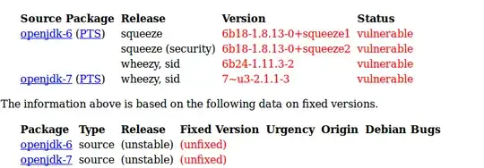

From here they said it was reported as CVE-2012-4681 for Oracle Java 7 Update 6, and possibly other versions ,
It seems that it has not been reported or accounted for Ubuntu yet but can be seen reported for Debian as here for packages openjdk-6 and openjdk-7 , so i guess it applies here too.
If i am guessing it right ,same version exists for Ubuntu here
So please disable it , to be assured for safer side .

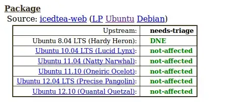

Edit (1-9-2012) It is now addressed by Ubuntu Security team as can be seen here . Security update for the package will soon be provided ,i guess.
Icetea-Web package includes the Plugin , which seems to have not being affected as here.
You can click the Ubuntu link as above to see the packages in it .So i guess , you are safe to use it.

It seems that IcedTea plugin is safe (contrary to what is stated above), here I copy from the RedHat site (also mentioned above):
Tomas Hoger 2012-08-27 09:09:03 EDT
Code execution was confirmed with the latest Oracle and IBM Java 7 web browser plug-in. IcedTea-Web using OpenJDK7 blocks this exploit by not allowing applet to change the SecurityManager (which is allowed in Oracle and IBM Java plugin).
Java 6 is currently not known to be affected.
