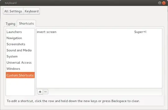

You can install it using sudo apt-get install xcalib. To make it more convenient assign a keyboard shortcut opening the Keyboard settings.
Keyboard Settings for adding manual shortcut
There, navigate to shortcuts. Add a custom shortcut by pressing the plus button, add the name and the command. It will be disabled by default, so assign a shortcut by clicking on Disabled and perform the wanted shortcut, e.g. meta + i

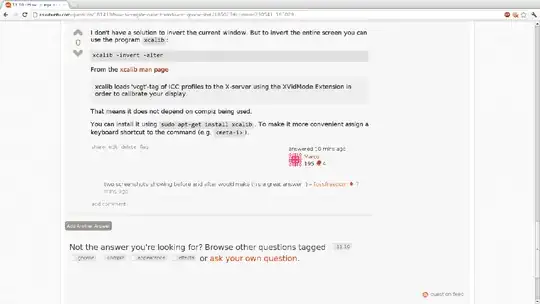

Before:
before

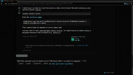

After xcalib -invert -alter was launched (mapped to <meta-i>:
after
Pressing it again restores to the normal not inverted screen.

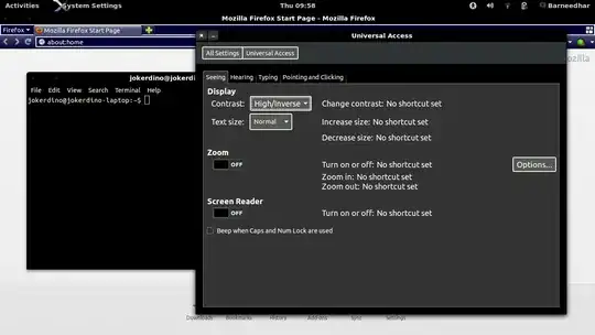

Perhaps, you can use a high / inverse contrast that sort of negates the windows. While this does not work for a browser's web pages (you could use browser specific solutions for that), it generally works for desktop applications.
Go to Universal Access and choose High / Inverse for Contrast. You could know have a white text in black background. While I admit this isn't the best solution, it should help you somewhat if you are desperate.
High Inverse
