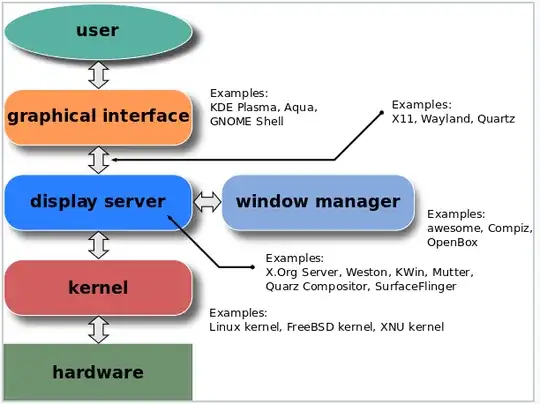

10
The picture and words from Wikipedia is helpful when I feel really confused by those concepts. display server and DE
There are not clear-cut definitions to distinguish them but there are strong patterns.
