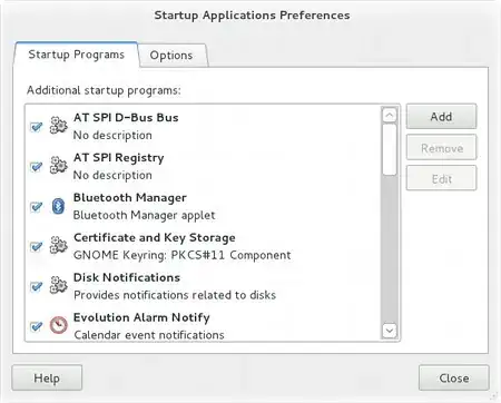

Also, as part of the Desktop environment, Lubuntu starts less programs in the background at login. You can see what apps are run at startup (login) on lubuntu , xubuntu, kde, and gnome by looking at startup in each DE
gnome
In general Lubuntu starts less apps, and thus uses less RAM at startup.
