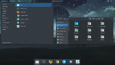

Gnome, KDE, Unity, Pantheon
Gnome, KDE, Unity, Pantheon are desktop environments.
A desktop environment consists of a lot of different tools. e.g: login manager, window manager, application launcher, menus, terminal emulator, file manager, web browser, editor, graphical tools for system configuration and a lot of other utilities. It's a complete package of everything you need.

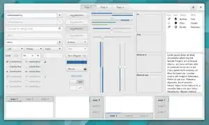

GTK and QT
GTK and QT are toolkits/framework to develop software, e.g: a lot of tools developed for Gnome desktop environment are usin GTK to make their GUI, instead of writing everything myself I can uses these to speed up my development and at the same time use and follow a standard framework which all other programs are using in a same environment.

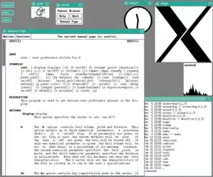

However even X needs a window manager to uses it's capabilities, it the bellow picture you see twm window manager and xterm and other stuff running a X session, for more information about window managers read the last section.

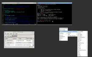

Window Managers
Window managers are mostly part of desktop environment, you can even use them instead of using a complete desktop environment. There are a lot of window managers available things like: i3wm, awesome, openbox, fluxbox, blackbox, xfwm4, compiz, etc.
They control how our windows act, how they look like, what elements they have, where should my title and default buttons show up, what happens if I drag/resize/close it? etc. Window managers uses display servers like X or Wayland to achieve these.
