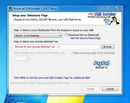

  1. get pendrivelinux software , for creating Live USB from windows .
2.follow these steps

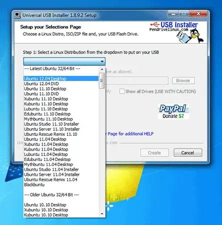

Select Ubuntu Desktop Edition from the dropdown list. enter image description here
click at browse and select your ISO file .Then click at create .this will create a live USB for you from windows .

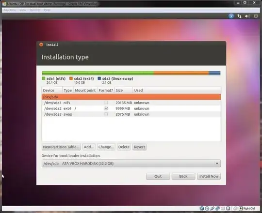

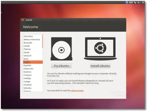

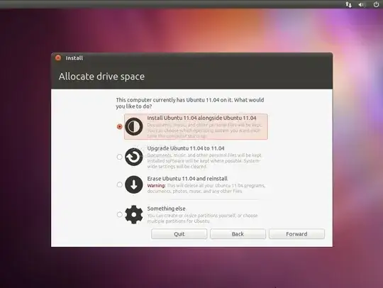

After Ubuntu loading , you will get like this enter image description here , choose Install Ubuntu .Then it will directs you to Preparing to install Ubuntu where it will check about minimum requirement . Internet connection doesn't matter but you should have minimum empty space as its mentioned .Then click at continue.Then next step is allocate drive step ,look at the image .enter image description here , here you have to choose what kind of install you want to give . each type have its clear description , so you can easily understand . there partitioning you have to mention . make sure that you have selected an empty partition for Ubuntu install or a partition which you dont want . enter image description here enter image description here
you have to select the partition and you have to select it as EXT4/EXT3 and then mount point as / then click at create . Size is your wish but make sure about the minimum size (> 5 GB) .Creating swap is a good move .
